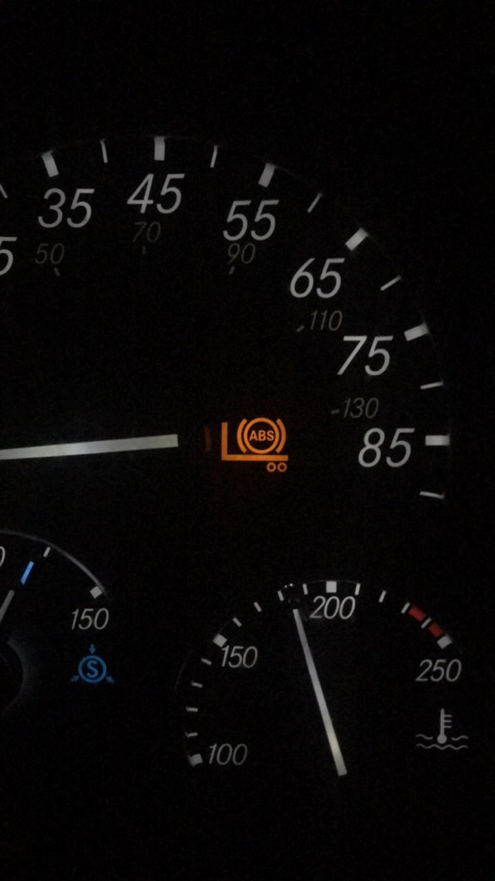

{"text":"The shop said they “repaired” it, on-road said he ”re-programed” it... but yet the ABS lights remain lit on both dash & trailer.. May have to deal with this matter myself 😡 ✂️","videos":"[]","link":"{}","pics":"[{\"description\":\"\",\"height\":1280.0,\"name\":\"\",\"url\":\"\",\"width\":720.0}]","canComment":true}

{"replyTo":"","text":"Have you checked the electrical cable-plug from tractor to trailer, it happens sometimes that the wires inside are either loose or grounding..... I have changed the plug once cause of the abs trailer light was on in my dashboard and it fixed it. ","replyToPid":0}

{"replyTo":"","text":"check the plug on the abs on the rims","replyToPid":0}

{"replyTo":"","text":"yeah, if the mechanics have already done their part, they may have overlooked the obvious. it could simply be a bad sensor or bad connection if the ABS system is working as it should.","replyToPid":0}

677601 发表于 2019-09-23 15:16:28 Have you checked the electrical cable-plug from tractor to trailer, it happens sometimes that the wires inside are either loose or grounding..... I have changed the plug once cause of the abs trailer light was on in my dashboard and it fixed it.
","text":"Will do 👍🏻","replyToPid":213598}

212424 发表于 2019-09-23 15:18:55 check the plug on the abs on the rims
","text":"Ok thanks ","replyToPid":213600}

716846 发表于 2019-09-23 16:20:46 yeah, if the mechanics have already done their part, they may have overlooked the obvious. it could simply be a bad sensor or bad connection if the ABS system is working as it should.
","text":"Yea I’ve been having problems with sensors in other areas too with this new truck","replyToPid":213640}

{"replyTo":"","text":"that happened to me. I asked an old guy parked next to me:\nhe said: speed up up to 5 miles and brake hard.\nit did fix it","replyToPid":0}

{"replyTo":"","text":"Mine was a bad fuse","replyToPid":0}

731713 发表于 2019-09-23 23:34:02 that happened to me. I asked an old guy parked next to me:\nhe said: speed up up to 5 miles and brake hard.\nit did fix it
","text":"😆 I actually tried that too ","replyToPid":213890}
