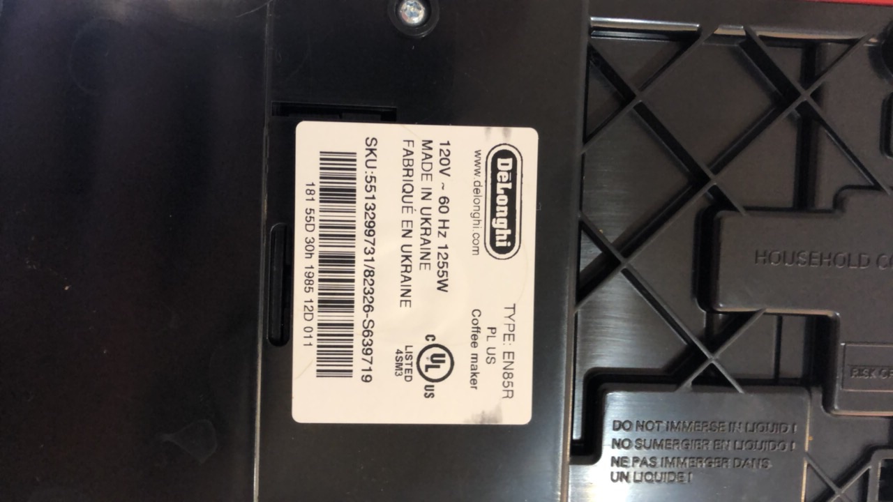

{"text":"Hi people,\n\nI recently purchased a Nespresso machine for my truck, only to find that the inverter installed doesn’t seem to want to power it. It works just dandy at home and I enjoy the coffee it makes so I don’t want to give it up. \n\nI drive a 2016 Volvo VNL780, and the inverter will power the toaster and the microwave together, and the printer works just fine. I really don’t know enough about electrical devices to get a handle on why this won’t work. \n\nAny advice would be welcomed. ","videos":"[]","link":"{}","pics":"[{\"description\":\"\",\"height\":720.0,\"name\":\"\",\"url\":\"\",\"width\":1280.0}]","canComment":true}

{"replyTo":"","text":"it's pulling 1255w. what's does your inverter handle?  microwave probably a 700w and toaster over I believe spikes at 900. Most coffee machines spike higher.  try using with truck ideling.  if that doesn't work your inverter isn't strong enough and you'll need a machine with lower watts.  look at single serve machines like kuriegs new one, mr coffee and couple others. they are small and pull less watts","replyToPid":0}

{"replyTo":"","text":"just go buy a bigger inverter","replyToPid":0}

{"replyToPid":0,"replyTo":"","text":"Yup, it’s all about the watts. \n\nFind out how many watts your inverter puts out.\n\nI have a keirug and only use it when the truck engine is on."}
