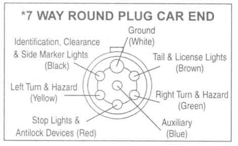

{"text":"I have an issue that started yesterday. I use 4 different dry vans and 2 skateboards. 2 of the vans have filament bulb clearance and side marker lights. The other 2 have all LED lights. The 2 with bulbs have LED tail and brake lights. Ok here is the problem. The 2 with the bulb clearance and side markers the red clearance at the back and the amber top front along with the rear bottom red marker don't work the tail lights and brake lights work. All lights work on the flatbeds and the other 2 vans (with all LEDs) I have checked power cord for voltage and it shows power there. What the heck is going on any ideas?How can the tail lights brake lights work but not the clearance lights? But all lights work on the LED trailers? Could it be it is getting enough voltage and just not enough current? I used this (see picture) to check thanks","pics":"[{\"description\":\"\",\"height\":289.0,\"name\":\"612963/ios_15483049810470.png\",\"url\":\"\",\"width\":471.0}]","canComment":true}
