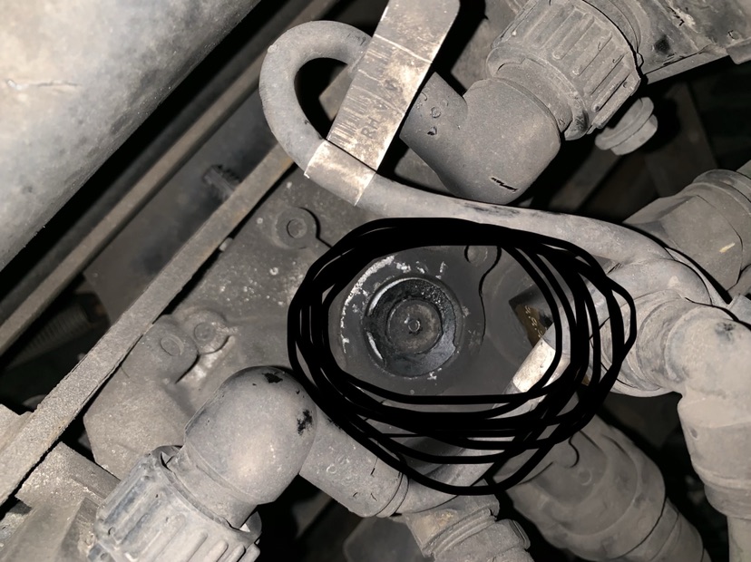

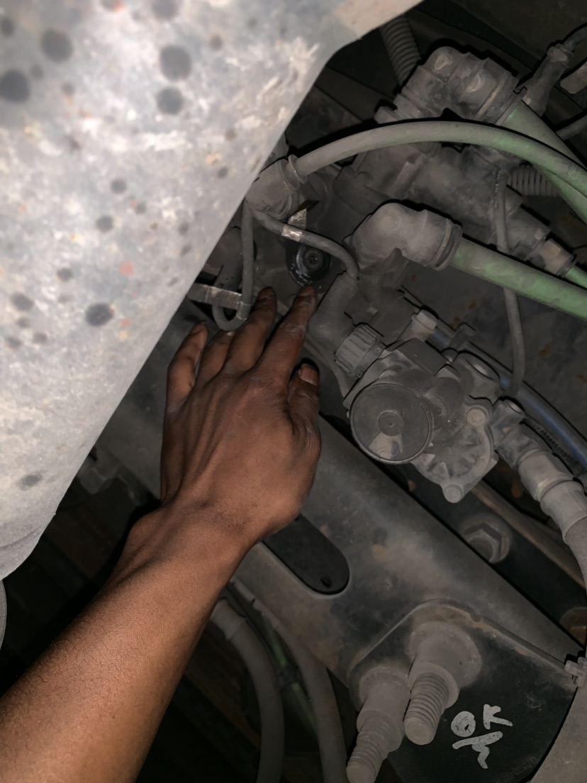

 楼主| 发表于 2019-6-13 11:20:14 来自手机 | 显示全部楼层 |阅读模式
{"text":"Anyone know what this is ","videos":"[]","link":"{}","pics":"[{\"description\":\"\",\"height\":620.0,\"name\":\"\",\"url\":\"\",\"width\":828.0},{\"description\":\"\",\"height\":1104.0,\"name\":\"\",\"url\":\"\",\"width\":828.0}]","canComment":true}

发表于 2019-6-13 13:39:16 来自手机 | 显示全部楼层
{"replyTo":"","text":"not a air dryer valve. have someone release then set brakes to see if it goes pshhhhh. it's an oring bad inside. valve repair kit should have the right oring just be careful its spring loaded","replyToPid":0}

发表于 2019-6-13 12:56:42 来自手机 | 显示全部楼层
{"replyTo":"","text":"that is an air dryer.","replyToPid":66040}

发表于 2019-6-13 13:41:54 来自手机 | 显示全部楼层
{"replyTo":"","text":"air dryers have a big filters on top of the valve","replyToPid":0}

发表于 2020-9-4 09:07:13 来自手机 | 显示全部楼层
{"replyTo":"","text":"Looks like a drain plug for\nPower steering pump. Not sure. Definitely a drain plug though ","replyToPid":0}
