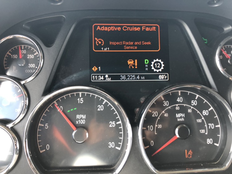

Here we go again ... great

{"text":"Just had it “fixed” last week","videos":"[]","link":"{}","pics":"[{\"description\":\"\",\"height\":562.0,\"name\":\"\",\"url\":\"\",\"width\":750.0}]","canComment":true}

发表于 2019-6-11 06:39:44 来自手机 | 显示全部楼层
{"replyTo":"","text":"Sometimes I think some of those mechanics don't really know 💩","replyToPid":0}

发表于 2019-6-11 07:49:20 来自手机 | 显示全部楼层
{"replyTo":"","text":"quit taking ur truck to ta","replyToPid":0}

发表于 2019-6-11 10:13:53 来自手机 | 显示全部楼层
{"replyTo":"","text":"I have  OnGuard on my truck and when it goes out it effects the cruise control so it doesn’t work until I would pull over, shut off the engine and restart it. Worked again. Got tired of pulling over and searched for how to bypass this while still rolling. For my truck, I have to press the cruise control on/off button three times then set my cruise. It’s now regular cruise without the OnGuard safety features (like the old days). Works for me everytime. I just ignore the faults, they go away after you restart the engine. Hope that helps you and others. I have a 2016 Freightliner cascadia evo.","replyToPid":0}

 楼主| 发表于 2019-6-11 10:53:01 来自手机 | 显示全部楼层
590319 发表于 2019-06-11 02:13:53 I have  OnGuard on my truck and when it goes out it effects the cruise control so it doesn’t work until I would pull over, shut off the engine and restart it. Worked again. Got tired of pulling over and searched for how to bypass this while still rolling. For my truck, I have to press the cruise control on/off button three times then set my cruise. It’s now regular cruise without the OnGuard safety features (like the old days). Works for me everytime. I just ignore the faults, they go away after you restart the engine. Hope that helps you and others. I have a 2016 Freightliner cascadia evo.
","text":"Mines completely bring my speedometer reading to under 0 mph, Even if I’m going 70.\nIt hasn’t lasted more than a couple of second when it goes away.\nIt was worse before I took it to Peterbilt dealership last week, it would lock in the gear I was on. (Transmission fault) until I stopped and  restart, sometimes it would go away after slowing down when pulling over to restart. \nI’ve tried to do that pressing the button 3 times. I’ve removed the connection to the radar but it turned on the ABS light.\nI wonder if there’s more with the same thing happening ...","replyToPid":63091}

发表于 2019-6-11 15:39:42 来自手机 | 显示全部楼层
{"replyTo":"","text":"that happened a lot to me when I drive through heavy rain.  it will act normal when it dries out. only affected my cruise control and nothing else","replyToPid":0}

发表于 2019-6-12 01:04:51 来自手机 | 显示全部楼层
656141 发表于 2019-06-11 02:53:01 Mines completely bring my speedometer reading to under 0 mph, Even if I’m going 70.\nIt hasn’t lasted more than a couple of second when it goes away.\nIt was worse before I took it to Peterbilt dealership last week, it would lock in the gear I was on. (Transmission fault) until I stopped and  restart, sometimes it would go away after slowing down when pulling over to restart. \nI’ve tried to do that pressing the button 3 times. I’ve removed the connection to the radar but it turned on the ABS light.\nI wonder if there’s more with the same thing happening ...
","text":"It’s possible. Someone has to have an answer hopefully.","replyToPid":63108}
