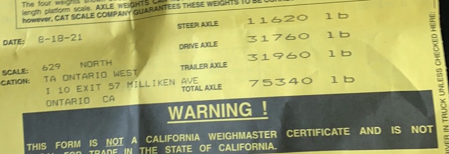

 楼主| 发表于 2021-8-19 06:43:19 来自手机 | 显示全部楼层 |阅读模式
{"text":"Got pulled over at WEIGH STATION and level 2 inspection , officers said I was good no ticket just warning because I was over in my axles … in other states this balance is legal. Why is this a problem in California??","videos":"[]","link":"{}","pics":"[{\"description\":\"\",\"height\":310.0,\"name\":\"\",\"url\":\"\",\"width\":900.0}]","canComment":true,"externalShare":false}

发表于 2021-8-19 20:44:35 来自手机 | 显示全部楼层
1280684 发表于 2021-08-19 11:30:01 Thats what i was thinking. My trailers are marked to the length that the axles need to be based on what state ill be going to.
","text":"If you are in Cali you cannot be over 40’ no matter where you are going. If you set your tandem for any other state you were illegal in Cali. ","replyToPid":440784}

发表于 2021-8-19 17:41:10 来自手机 | 显示全部楼层
{"replyTo":"","text":"Over length on your axles maybe? Definitely not overweight ","replyToPid":0}

发表于 2021-8-19 19:30:01 来自手机 | 显示全部楼层
936953 发表于 2021-08-19 09:41:10 Over length on your axles maybe? Definitely not overweight
","text":"Thats what i was thinking. My trailers are marked to the length that the axles need to be based on what state ill be going to.","replyToPid":440780}

发表于 2021-8-19 14:12:52 来自手机 | 显示全部楼层
{"replyTo":"","text":"Would only be an issue if you're truck manufacturer front axle was made for 11,500 which is EXTREMELY rare and I'm assuming it's not. If you were issued a written warning though, can't fight it, hit against your license where with this kind of proof a ticket it something you could have easily won.","replyToPid":0}

发表于 2021-8-20 02:03:03 来自手机 | 显示全部楼层
{"replyTo":"","text":"Each Axle should be rated at 17,000 lbs. individually, 2 axles in tandem are at 34,000 lbs. (drive tandem and trailer tandem) Your scale ticket is good. If you have a standard 5 axle dry or reefer van configuration, then the reference would be that 1 axle was over the 17,000 lbs. but the axle tandem as a group was under as your CAT ticket shows. (I’m guessing)\n\nFYI, future reference, the drive axle tandem has a 400 lbs. weight waiver allowance for trucks with APU’s installed. So, your weight could appear as: Steer-12,000, Drives-34,400, and Trailer-33,600. The waiver does not allow for over gross. Gross still at 80,000 lbs. (last I checked, info might have changed)\n\n","replyToPid":0}

发表于 2021-8-21 21:16:14 来自手机 | 显示全部楼层
{"replyTo":"","text":"I was thinking it might be the spacing rolling legal is one thing - but rolling Cal. Legal is another. slide them axles all the way up, then scale the load","replyToPid":0}

{"replyTo":"","text":"I don’t think so buddy, I am from Califirnia & I hv been pulled out so many times, but I think this Weight is very Ok, no issues with any Law of Weight in Truck or Scales..\n","replyToPid":0}
