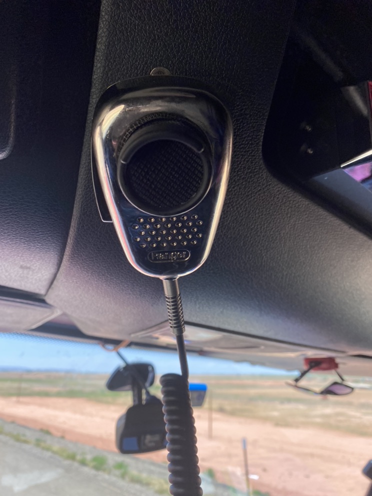

{"text":"I have a Stryker -SR497-HPC 10 meter Radio and a Wilson 5000 antenna every time I speak into the mic other drivers say I have to much power and they can’t understand what I’m saying. How do I reduce the power for a clear transmission ","videos":"[]","link":"{}","pics":"[{\"description\":\"\",\"height\":568.0,\"name\":\"\",\"url\":\"\",\"width\":756.0},{\"description\":\"\",\"height\":992.0,\"name\":\"\",\"url\":\"\",\"width\":744.0}]","canComment":true,"externalShare":false}

{"replyTo":"","text":"My first suggestion would be hold the mic a little further from your face and speak in an a normal speaking voice. That makes a huge difference!","replyToPid":0}

{"replyTo":"","text":"That picture is a little blurry but look for one that says mic gain or something like that. Turn it down about half way and see how it goes. I had the same deal with the guard shack and it cleared it up. Hope it helps you. ","replyToPid":0}

{"replyToPid":0,"replyTo":"","text":"also speak with the mic on the side of your mouth not directly at it. Try backing off the dynamike may be wound too tight"}

{"replyTo":"","text":"turn your mic gain back a bit and a good noise cancelling mic wouldn't hurt RK56 even a A static works good","replyToPid":0}

","text":"The mic I have is a ranger noise canceling mic I was told I have to keep it close","replyToPid":386471}
