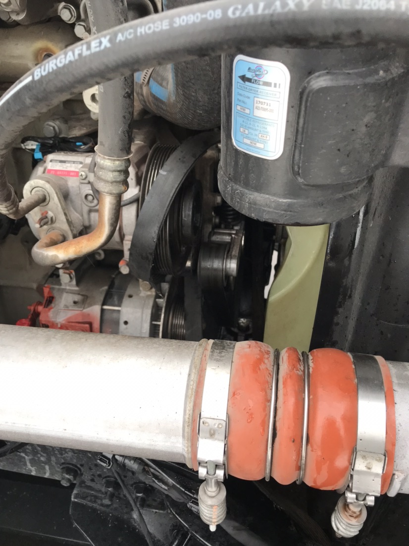

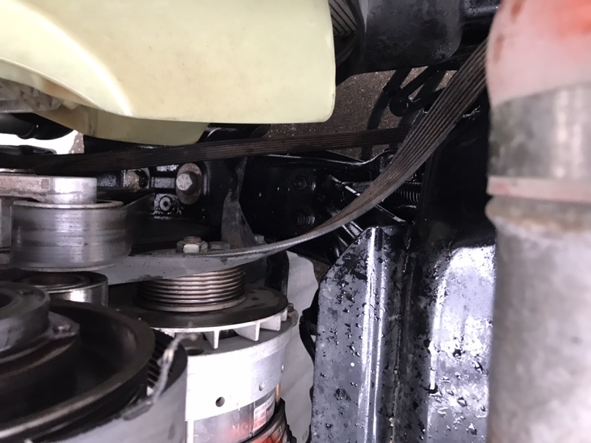

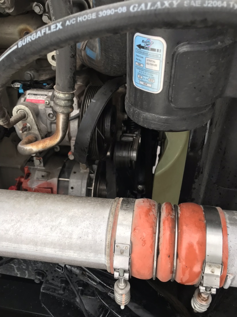

While I was in Milwaukee started the Truck and the Belt Flew off

 楼主| 发表于 2019-11-2 14:18:47 来自手机 | 显示全部楼层
689986 发表于 2019-11-02 04:09:11 I carry extra parts in my tractor for chit like this. Is that a Cummings? Probably need to replace that dámn tensioner
","text":"That what it was the Tensioner spring gave away I didn’t know Tensioners went out just like that ","replyToPid":240277}

 楼主| 发表于 2019-11-2 08:35:09 来自手机 | 显示全部楼层
612134 发表于 2019-11-02 00:09:59 could've been avoided. if you did a proper pre-trip and saw it was not tight. then all you would have had to do was tighten it up. Now you have to replace it.
","text":"It was tight it came off while we where on the Freeway we pulled into a TA got coffee just came from Kentucky and after 20 mins down the Road the Temp light came on so I’m like What’s this so I popped the hood and noticed the fan wasn’t turning and the Belt was off so the  mechanic said it had a bad tensioner on it    ","replyToPid":240041}

 楼主| 发表于 2019-11-2 08:31:13 来自手机 | 显示全部楼层
69483 发表于 2019-11-01 23:53:58 sadly that's one of the shitty parts of trucking.  how's the weather up in Milwaukee right now?
","text":"Terrible","replyToPid":240022}

发表于 2019-11-3 08:28:07 来自手机 | 显示全部楼层
{"replyToPid":0,"replyTo":"","text":"You got lucky.\nSame thing happened to me 3 years ago while climbing a hill in Utah in the center lane passing slower trucks.  Tensioner failing caused the belt to slip off and shred.  Just a few secs of flapping around before breaking completely and it ripped open the hose coming off the bottom of the radiator dumping all my coolant along with ripping off the engine temp sensor and coolant level senser.\n\nRoad service to fix the hose, belt, and 10 or so gallons of coolant.  Drove the truck to a shop for the sensors (luckily it was winter and no more big hills so engine heat wasn't a concern).  Tensioner was on a 4 month backorder everywhere so couldn't get the failing one replaced.  Stopped leasing the truck 3 months later when the warranty expired so no clue if it ever got fixed."}

 楼主| 发表于 2019-11-3 09:36:37 来自手机 | 显示全部楼层
280160 发表于 2019-11-03 00:28:07 You got lucky.\nSame thing happened to me 3 years ago while climbing a hill in Utah in the center lane passing slower trucks.  Tensioner failing caused the belt to slip off and shred.  Just a few secs of flapping around before breaking completely and it ripped open the hose coming off the bottom of the radiator dumping all my coolant along with ripping off the engine temp sensor and coolant level senser.\n\nRoad service to fix the hose, belt, and 10 or so gallons of coolant.  Drove the truck to a shop for the sensors (luckily it was winter and no more big hills so engine heat wasn't a concern).  Tensioner was on a 4 month backorder everywhere so couldn't get the failing one replaced.  Stopped leasing the truck 3 months later when the warranty expired so no clue if it ever got fixed.
","text":"Wow that sounded like a nightmare I probably would’ve said F this and I bet it was very costly ","replyToPid":240984}
