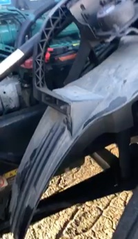

HELP!!! Volvo engine d13 what is this problem? How much will the repair cost?
 楼主| 发表于 2020-4-14 09:16:30 来自手机 | 显示全部楼层 |阅读模式
{"text":null,"videos":"[{\"url\":\"http://d2w8udw005hdju.cloudfront.net/video/329044/ios_949543_1586826955551.mp4\"}]","link":"{}","pics":"[{\"description\":\"\",\"height\":345.0,\"name\":\"\",\"url\":\"\",\"width\":200.0}]","canComment":true,"externalShare":false}

发表于 2020-4-14 10:30:33 来自手机 | 显示全部楼层
{"replyTo":"","text":"Why do you own a volvo?","replyToPid":355654}

发表于 2020-4-14 11:33:06 来自手机 | 显示全部楼层
{"replyTo":"","text":"You could try FTC decarbonizer if filter or new separator does not fix it","replyToPid":0}

发表于 2020-4-14 11:10:29 来自手机 | 显示全部楼层
{"replyToPid":0,"replyTo":"","text":"first replace crankcase filter.\nfor a temporary fix you can take a 1 inch rubber hose and loop it around from the inlet to the outlet of your crankcase filter then just run a hose from the valve cover down then see if its better.\nif it  still a problem probably going to need a rebuild."}

发表于 2020-4-14 10:27:02 来自手机 | 显示全部楼层
{"replyTo":"","text":"Keep at 600 rpm all night and all day that what you get after 3 of 4year blowby good lock\n","replyToPid":0}

发表于 2020-4-14 11:02:04 来自手机 | 显示全部楼层
{"replyToPid":355706,"replyTo":"","text":"no, just curious how that pipe is blowing out air. I thought that's an atmosphere balance outlet.\n\nmy guess is you have worn piston rings."}

发表于 2020-4-14 11:08:51 来自手机 | 显示全部楼层
no, just curious how that pipe is blowing out air. I thought that's an atmosphere balance outlet. my guess is you have worn piston rings.
{"replyToPid":355711,"replyTo":"
945420 发表于 2020-04-14 03:02:04 no, just curious how that pipe is blowing out air. I thought that's an atmosphere balance outlet.\n\nmy guess is you have worn piston rings.
","text":"possible but more likely on d13 it's a plugged crankcase filter or bad crankcase breather/oil separator.\nit's a centrifuge cartridge."}
