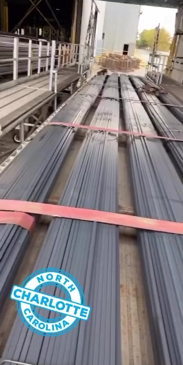

How would u guys secure this load of flat steel? Chains and straps? Just chains or just straps? (5 bundles.... 48k lbs)

 楼主| 发表于 2019-10-9 05:16:39 来自手机 | 显示全部楼层 |阅读模式
{"text":null,"videos":"[{\"url\":\"http://d2w8udw005hdju.cloudfront.net/video/213546/ios_827022_1570569188957.mp4\"}]","link":"{}","pics":"[{\"description\":\"\",\"height\":716.0,\"name\":\"\",\"url\":\"\",\"width\":360.0}]","canComment":true}

发表于 2019-10-9 06:20:22 来自手机 | 显示全部楼层
{"replyTo":"","text":"wow; without blocking in between; thats crazy! ! either block it ; OR  have them load it touching! YOU CANNOT SPACE THAT LOAD OUT LIKE THAT WITHOUT BLOCKS IN BETWEEN! ","replyToPid":0}

 楼主| 发表于 2019-10-9 05:47:01 来自手机 | 显示全部楼层
452317 发表于 2019-10-08 21:37:41 someone might come in and say im wrong.   as far as I know.     if you don't have t blocks in between the bundles.   you could get a securment ticket.
","text":"I’m not sure .... I thought u were just supposed to individually belly wrap the bundles if there weren’t any blocking ...... Gerdau steel didn’t put blocking on any ones load","replyToPid":223830}

发表于 2019-10-9 06:31:08 来自手机 | 显示全部楼层
{"replyTo":"","text":"flatbed aint no joke! third of all trick; do whats safe ; and tarp if your worried about cops seeing it; but thats dangersos with the spacing; you are just not noticing how damgerous it is cause the stwel is soooo heavy and not moving right now; but 80 miles an hour out of gear down a hill round a bend that load will shift; ","replyToPid":0}

发表于 2019-10-9 06:23:37 来自手机 | 显示全部楼层
{"replyTo":"","text":"second of all; like that guy already said; chains on metal; straps on everything else straps on wood or whatever; but wow; that load with that space in between is very dangerous! ive seen guys chain up pretty  well and have loads shift on the side of the road; let alone strapping; ","replyToPid":0}

发表于 2019-10-9 07:48:34 来自手机 | 显示全部楼层
827022 发表于 2019-10-08 23:01:14 Well how would i secure the load if it was all together????
","text":"you would choke or belly strap all the bundles as one in the front and back.   strap or chain the rest.. as far as how do you handle them not blocking it.   if you feel the load is unsafe you refuse it, period.","replyToPid":223872}

 楼主| 发表于 2019-10-9 07:01:14 来自手机 | 显示全部楼层
824549 发表于 2019-10-08 22:59:46 take care though; in theory you want your load alll touching each other,
","text":"Well how would i secure the load if it was all together???? ","replyToPid":223871}

 楼主| 发表于 2019-10-9 06:10:59 来自手机 | 显示全部楼层
755304 发表于 2019-10-08 21:53:50 I would say if you have front and back of each bundle chokes or belly wrap your good but throw a few extra straps on  but there should be blocking in between them . Make sure each bundle is secure from sliding
","text":"We were taught how to secure these types of loads in load securement with and without blocking ..... a lot of steel places that I’ve gone to do not put the blocking in between ..... I would imagine that we could use our 1 ft blocks to create our own blocking but I’m not sure ","replyToPid":223841}

 楼主| 发表于 2019-10-10 11:53:43 来自手机 | 显示全部楼层
{"replyTo":"","text":"So I individually belly wrapped each bundle and tightened em down really tight... I was told that using chains on this load will damage the freight and this type of flat steel is easier to slide through the chains than it is the straps..... Load is already delivered and never shifted at all..... I saw other drivers that do not work for my company with the  exact same securement as well.... Also I was told that using chains will bunch the steel up together in more of a round shape than keeping it flat which will most likely cause some of the pieces of steel to walk out.... I don't make the rules I'm just doing as I was taught ","replyToPid":0}

发表于 2019-10-9 06:42:07 来自手机 | 显示全部楼层
{"replyTo":"","text":"they will not wanna fix the load yhey will be mad and irritated you gottta watch them as they lof and nip that s$&@ in the bud would you load crates or pallets with the spacing ? no cause the lighter loads you would see the shiftness this load yall are getting away with it cause its ao heavy its stable; and so long ; and god willing your not slamming the brakes round a bend down hill all at tue same time","replyToPid":0}

发表于 2019-10-9 06:26:44 来自手机 | 显示全部楼层
{"replyTo":"","text":"the belly wrapping i only do id something is round ; or can move something on wheels; or something on only one side of a trailer by itself; usually a partial load type; or like one single pipe  by itself type situation; i would not belly wrap that; i would chain it straight ways  that beibg said guy flatbed aint no joke! and i could care less about a violation or ticket; thats dangerous if that space is allllll there right now ? and your driving right now?  ","replyToPid":0}

发表于 2019-10-9 05:35:36 来自手机 | 显示全部楼层
{"replyTo":"","text":"can't tell from your video.   do you have T blocks? something in between the bundles.   I was always taught metal on metal.   fiber on fiber.  Anymore, I would strap that load.  that's my opinion.","replyToPid":0}

 楼主| 发表于 2019-10-9 05:36:55 来自手机 | 显示全部楼层
452317 发表于 2019-10-08 21:35:36 can't tell from your video.   do you have T blocks? something in between the bundles.   I was always taught metal on metal.   fiber on fiber.  Anymore, I would strap that load.  that's my opinion.
","text":"Nope no blocking in between and it’s 53ft long ..... very flexible as well ","replyToPid":223828}

发表于 2019-10-9 05:37:41 来自手机 | 显示全部楼层
{"replyTo":"","text":"someone might come in and say im wrong.   as far as I know.     if you don't have t blocks in between the bundles.   you could get a securment ticket.","replyToPid":0}

发表于 2019-10-9 05:53:50 来自手机 | 显示全部楼层
{"replyTo":"","text":"I would say if you have front and back of each bundle chokes or belly wrap your good but throw a few extra straps on  but there should be blocking in between them . Make sure each bundle is secure from sliding ","replyToPid":0}

 楼主| 发表于 2019-10-9 06:22:02 来自手机 | 显示全部楼层
{"replyTo":"","text":"Wow that’s crazy never knew that .... Gerdau steel loads everyone like this and all the other truckers were leaving out wit their loads individually belly wrapped ","replyToPid":0}
