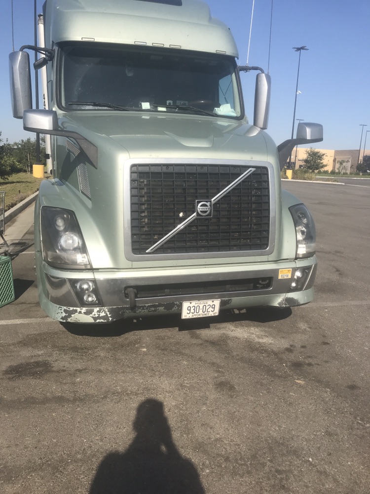

 楼主| 发表于 2019-8-26 00:38:44 来自手机 | 显示全部楼层 |阅读模式
{"text":"How many people have this problem? \nI got a new to me truck 2015 Volvo. Great truck but the headlights and fog lights were all yellow and oxidation had set in so I looked up on YouTube about fixing this permanently. A lot of people try toothpaste and it works for about two weeks. This job I did I did today and will update this to let you know how long it works. Here’s what I did sanded the headlights with 400 800 and 1200 grit water sandpaper wet the headlights and sand paper sand then cleaned it with alcohol and lint free paper towels then clear coat with yellow resistant and UV protectant spray paint and looks really nice right now. ","videos":"[]","link":"{}","pics":"[{\"description\":\"\",\"height\":1000.0,\"name\":\"\",\"url\":\"\",\"width\":750.0}]","canComment":true}

发表于 2019-8-26 03:18:56 来自手机 | 显示全部楼层
{"replyTo":"","text":"YOU DID ALL THAT AND JUST A FEW SPRAYS WITH WD-40 WOULD HAVE TAKEN CARE OF THAT PROBLEM","replyToPid":0}

 楼主| 发表于 2019-8-28 10:56:24 来自手机 | 显示全部楼层
157862 发表于 2019-08-25 18:03:29 Where you at?  I’ll be right there and you can test my headlights too
","text":"Lol will cost you about $30.00 for materials and I know you can’t afford my labor rates","replyToPid":191391}

 楼主| 发表于 2019-8-28 10:56:52 来自手机 | 显示全部楼层
505487 发表于 2019-08-25 19:18:56 YOU DID ALL THAT AND JUST A FEW SPRAYS WITH WD-40 WOULD HAVE TAKEN CARE OF THAT PROBLEM
","text":"For how long","replyToPid":191533}
