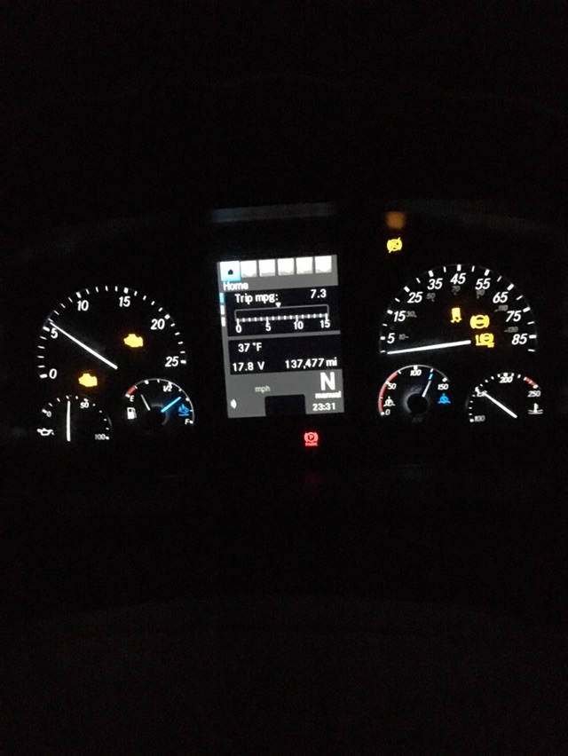

{"text":"Hey drivers just trying figure out why all these fault codes are appearing and disappearing over and over again. Then I’m getting a over voltage warning. And my ABS light on my trailer is going crazy on and off. I just changed my alternator and I think it’s a bad fuse somewhere but not sure. If you know anything about this I would greatly appreciate it. Take care and drive safe drivers.","videos":"[]","pics":"[{\"description\":\"\",\"height\":852.0,\"name\":\"\",\"url\":\"\",\"width\":640.0}]","canComment":true}

{"replyTo":"","text":"Loose ground connection to the alternator exactly what you said. Thanks again ","replyToPid":0}

{"replyTo":"","text":"seems to me like that over voltage warning is clearly related to your alternator replacement, and likely the cause of all of your issues.I would take it back to the dealer and have an external voltage measurement taken.","replyToPid":0}

{"replyTo":"","text":"i had a similar issue with mine it was just a simple stripped wire... dealers couldn't figure it out for 2 months until one day my headlight was flickering and a cop pulled me over... everything is connected to \"SSAM and CPC\" if one shorts they all light up like Christmas","replyToPid":0}

544635 发表于 2019-04-01 19:51:45 Thanks drivers I was able to find and fix the problem thanks to all of you. Be safe out there
","text":"care to share the diagnosis","replyToPid":7741}

620921 发表于 2019-04-01 15:54:42 I'll go with goose on this one. Have a mechanic check it already. Might cause more issues if you are trying to fix something that you ain't that familiar with
","text":"Yeah, 17.8 V is, uh, a little high lol.","replyToPid":7658}

{"replyTo":"","text":"Yeah check the grounds from the alternator to the batteries and all do the batteries. ","replyToPid":0}

{"replyTo":"","text":"check the ground","replyToPid":0}
