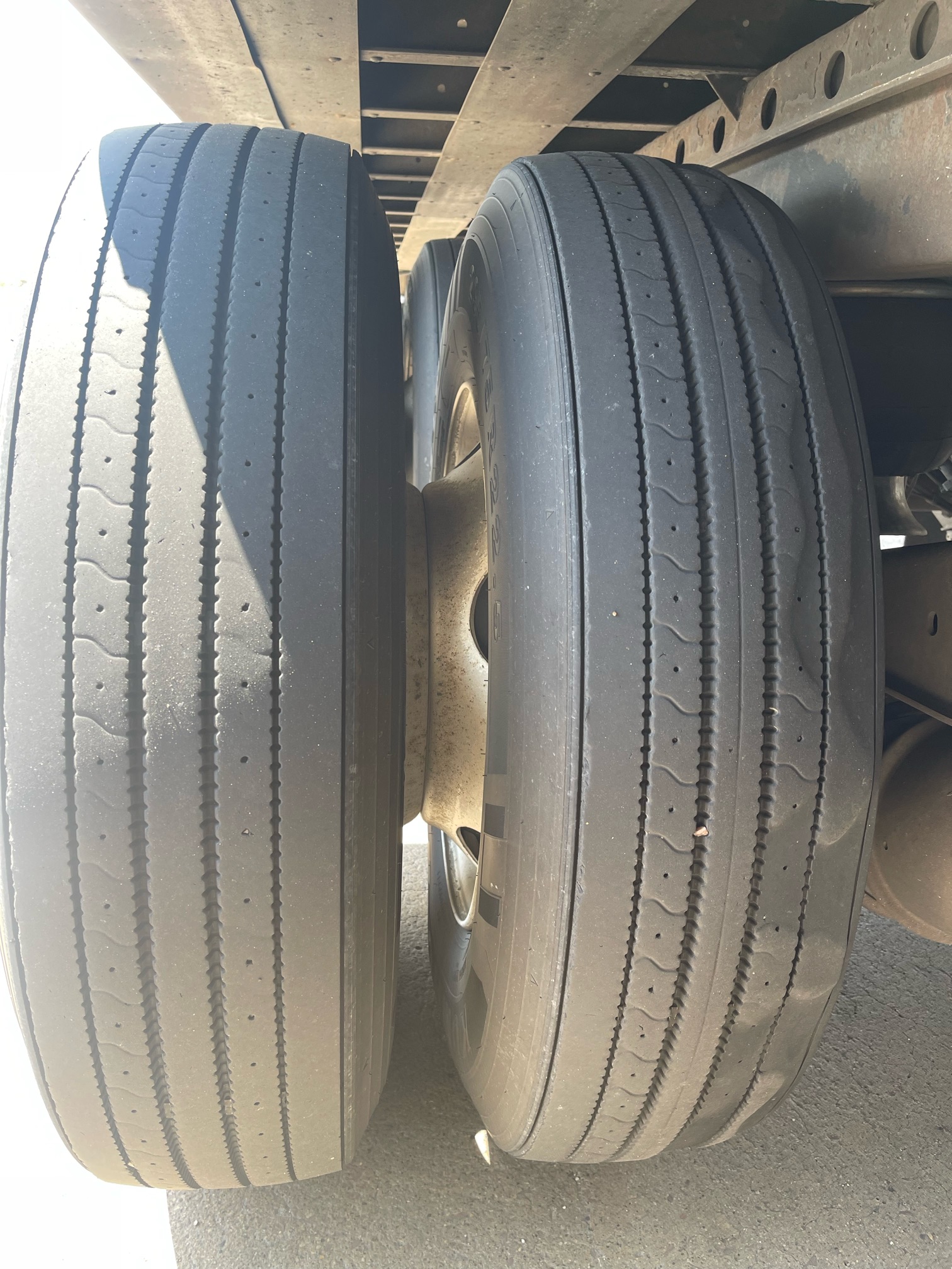

{"text":"Anybody now why tire worn like that ? Only this tire all other tires are good ","videos":"[]","link":"{}","pics":"[{\"description\":\"\",\"height\":2016.0,\"name\":\"\",\"url\":\"\",\"width\":1512.0}]","canComment":true,"externalShare":false}

{"replyTo":"","text":"no one mentioned could be the loose nut behind the steering wheel ???","replyToPid":0}

{"replyTo":"","text":"Many things:\n1st: low pressure tire \n2nd: shocks are bad \n3rd: hub bearing needs adjustment \n4th: bushings \n5th: alignment \n6th: bad/cheap tire and last one bad installed tire on rim.","replyToPid":0}

{"replyTo":"","text":"This could be a bearing problem or axle flexing. ","replyToPid":0}

{"replyTo":"","text":"It's called cupping/scallop wear and it's only on one side so you have multiple issues.","replyToPid":0}

{"replyTo":"","text":"Trailer needs an alignment ","replyToPid":0}

{"replyTo":"","text":"bearing","replyToPid":0}

{"replyTo":"","text":"It could  be cheap tire not enough air pressure it could be a lot of things ","replyToPid":0}

{"replyTo":"","text":"maybe turning to sharp in parking lots 🤔","replyToPid":0}

{"replyTo":"","text":"Or a bad rim or alignment","replyToPid":0}

{"replyTo":"","text":"Could also be a bad retread on the tire","replyToPid":0}

{"replyTo":"","text":"Shocks absorb must be the problem ","replyToPid":0}

{"replyTo":"","text":"It could potentially be the air bags not inflating properly, each bump to be having the crossmember rub/take a chunk. ","replyToPid":0}

{"replyTo":"","text":"alignment, causes the tire to want to go in a different direction and that causes bouncing.","replyToPid":0}
