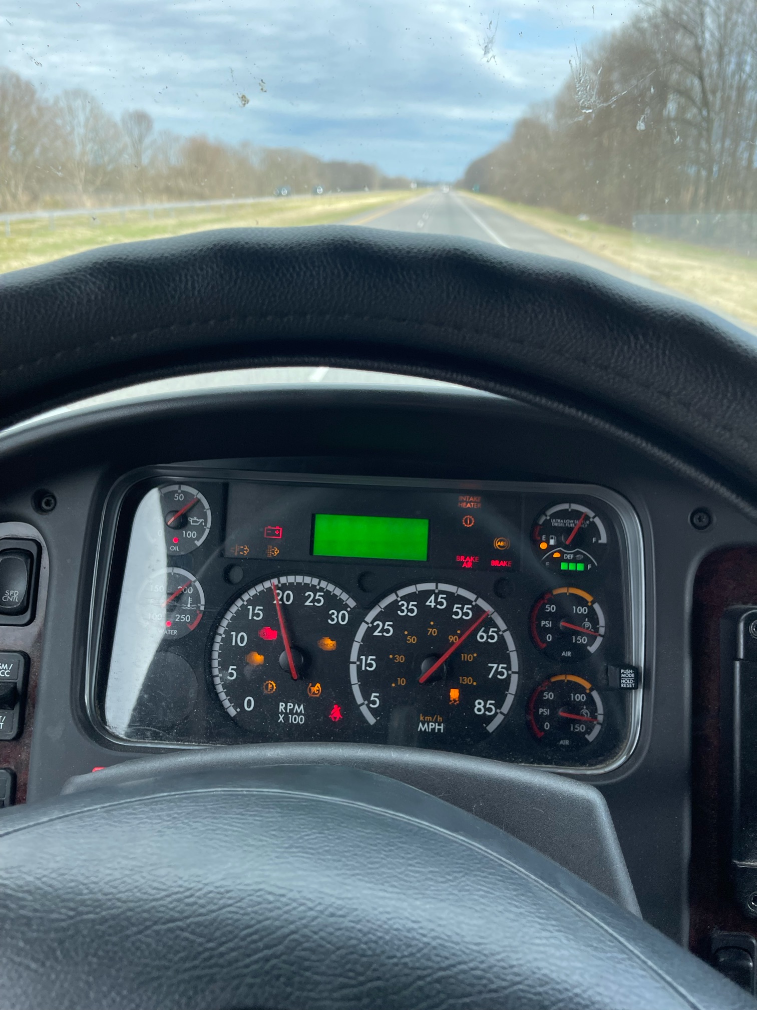

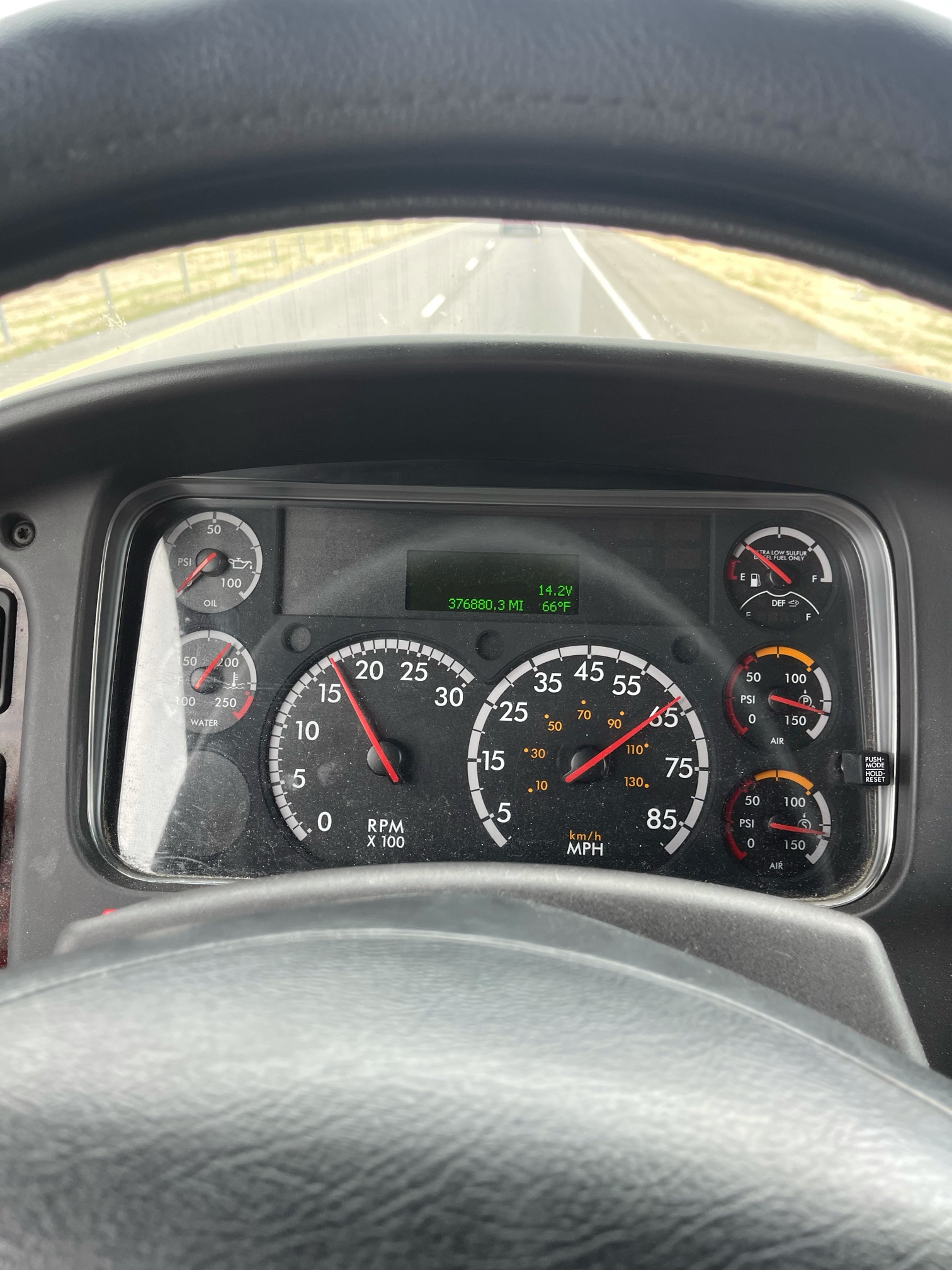

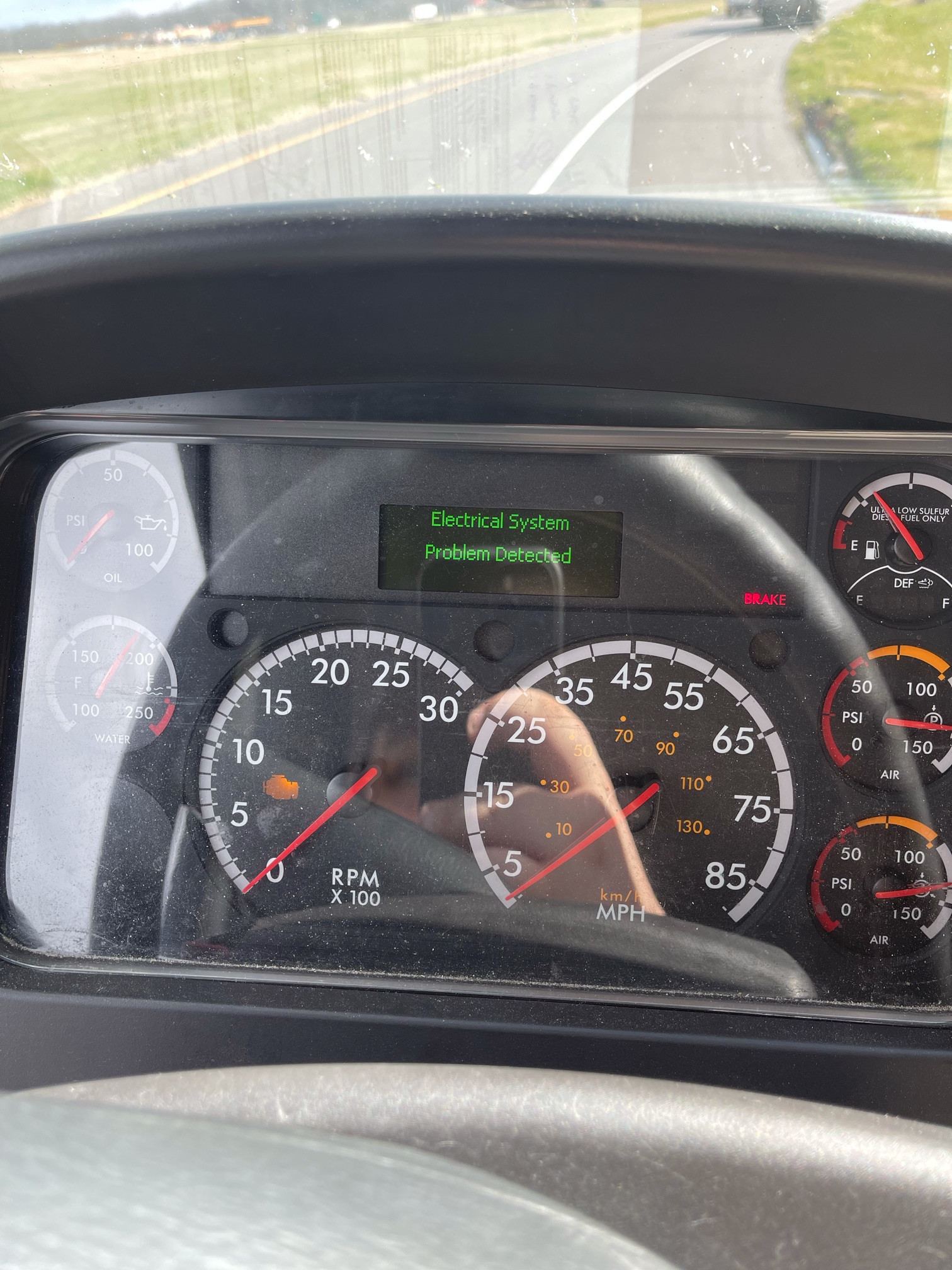

{"text":"Hit a pothole and truck completely shut off and restarted. \n\nOil pressure read 0… so I pulled over right away.. I do PTI regularly and oil level was on par.. I checked it anyway and still full .. checked all wiring nothing damaged.. checked fuse box no blown fuses or relays.. plugged the laptop in.. J Pro software read there’s nothing wrong. I’m beginning to think that the chassis body module is on it way out.. does any one other opinions on what it might be.. or had experience with this issue on their Freightliner ","videos":"[]","link":"{}","pics":"[{\"description\":\"\",\"height\":2016.0,\"name\":\"\",\"url\":\"\",\"width\":1512.0},{\"description\":\"\",\"height\":2016.0,\"name\":\"\",\"url\":\"\",\"width\":1512.0},{\"description\":\"\",\"height\":2016.0,\"name\":\"\",\"url\":\"\",\"width\":1512.0}]","canComment":true,"externalShare":false}
