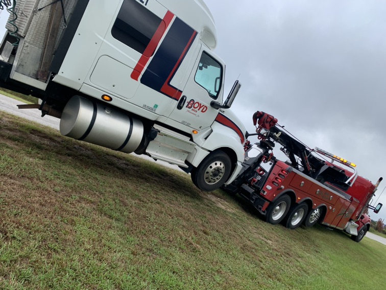

 楼主| 发表于 2020-9-12 22:37:09 来自手机 | 显示全部楼层 |阅读模式
{"text":null,"videos":"[]","link":"{}","pics":"[{\"description\":\"\",\"height\":568.0,\"name\":\"\",\"url\":\"\",\"width\":756.0}]","canComment":true,"externalShare":false}

发表于 2020-9-14 05:21:48 来自手机 | 显示全部楼层
{"replyTo":"","text":"Sounds like it was stuck on derade mode. Depending on the truck you have, next time that happens to you try unplugging the speed sensor. Doing this will allow you to drive at normal speed back home or to a shop. I've done this before to my freightliner and volvo. Theres plenty of videos on you tube that can show you how to do it.","replyToPid":0}

 楼主| 发表于 2020-9-14 04:14:30 来自手机 | 显示全部楼层
{"replyTo":"","text":"It wouldn’t move past 5mph\nLuckily the shop wasn’t too far but doesn’t open until tomorrow.⏳\n","replyToPid":397089}

 楼主| 发表于 2020-9-14 09:45:48 来自手机 | 显示全部楼层
200820 发表于 2020-09-13 21:21:48 Sounds like it was stuck on derade mode. Depending on the truck you have, next time that happens to you try unplugging the speed sensor. Doing this will allow you to drive at normal speed back home or to a shop. I've done this before to my freightliner and volvo. Theres plenty of videos on you tube that can show you how to do it.
","text":"Thanks for the info!","replyToPid":397105}
