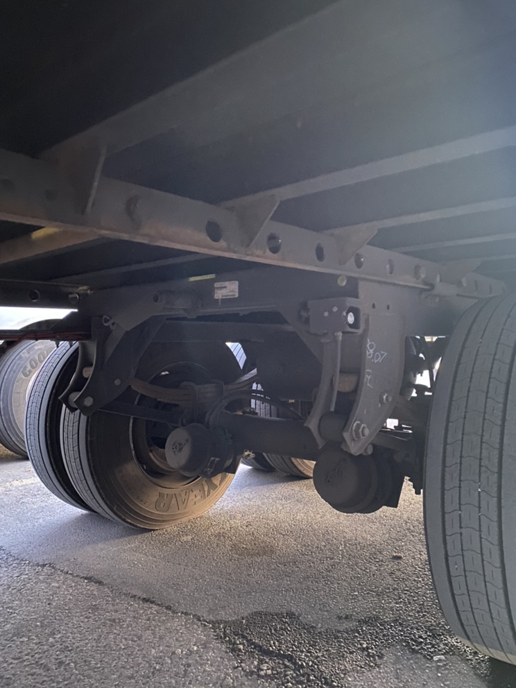

 楼主| 发表于 2020-2-27 12:31:51 来自手机 | 显示全部楼层 |阅读模式
{"text":"Good evening Guys, need u advice:\nI have 53 ft trailer and my pin in 7 holes\nDoes it legal or not in CA?\nI cannot slide close to front bc my trailer right now 33.800","videos":"[]","link":"{}","pics":"[{\"description\":\"\",\"height\":992.0,\"name\":\"\",\"url\":\"\",\"width\":744.0}]","canComment":true,"externalShare":false}

发表于 2020-2-27 12:59:28 来自手机 | 显示全部楼层
{"replyTo":"","text":"40’ should be the 4th “hole” not counting the stop hole.  You’re in the 6th hole now. Or measure 10’ from the rear of the trailer  to the center of the rear axle. ","replyToPid":0}

发表于 2020-2-27 19:32:18 来自手机 | 显示全部楼层
{"replyTo":"","text":"measure 10 feet from the rear of the trailer towards ur kingpin boom u are legal..","replyToPid":0}

发表于 2020-2-27 23:05:34 来自手机 | 显示全部楼层
{"replyTo":"","text":"5th hole or less for Cali, is how I was taught, and 5th wheel center, on almost every occasion. No matter how much I'm loaded with, I can usually always get it to balance with starting at the 5th hole on my tandems.","replyToPid":0}

发表于 2020-2-27 13:06:08 来自手机 | 显示全部楼层
{"replyTo":"","text":"Slide your 5th wheel forward 2 notches. Adjust your trailer tandems to the 4th hole. You should be legal or very close to legal on your axle weights. ","replyToPid":0}

发表于 2020-2-27 12:39:33 来自手机 | 显示全部楼层
{"replyToPid":0,"replyTo":"","text":"40' in California. Weight does not matter in California"}
